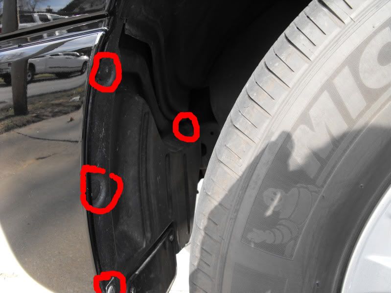

    I searched high and low on multiple sites trying to find out how the heck to remove the fog lights in my truck. No such luck, I guess. So, I decided to make this thread to help anyone who needs it.
    First you take these four tabs out by prying them with a flat head screwdriver.
    Then you go under and take these two screws out.
    I think they are 10mm. After that the lower part of the wheel well should just pull right out.
    Take the fog light bulb out, and then squeeze the circled button and push it through the hole.
    Then on the right and left side there are tabs holding the housing in. You can take one out by hand, then the other out by prying it with a screwdriver. Be careful and put a free hand on the outside where the glass is because it will roll out. And this is what you should have when you pull it out.
    And that's it. Hope this helps at least someone.
